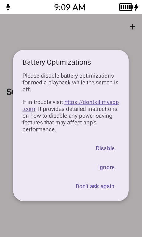

Additionally, there’s a high probability - This music app bypasses Kompakt battery power-saving security
PLUS, we have to take into consideration that TEMPUS, is not simple music app - it is streaming from home server. We can see that stream caching size is 256mb which is super high, even for a traditional smartphone.
