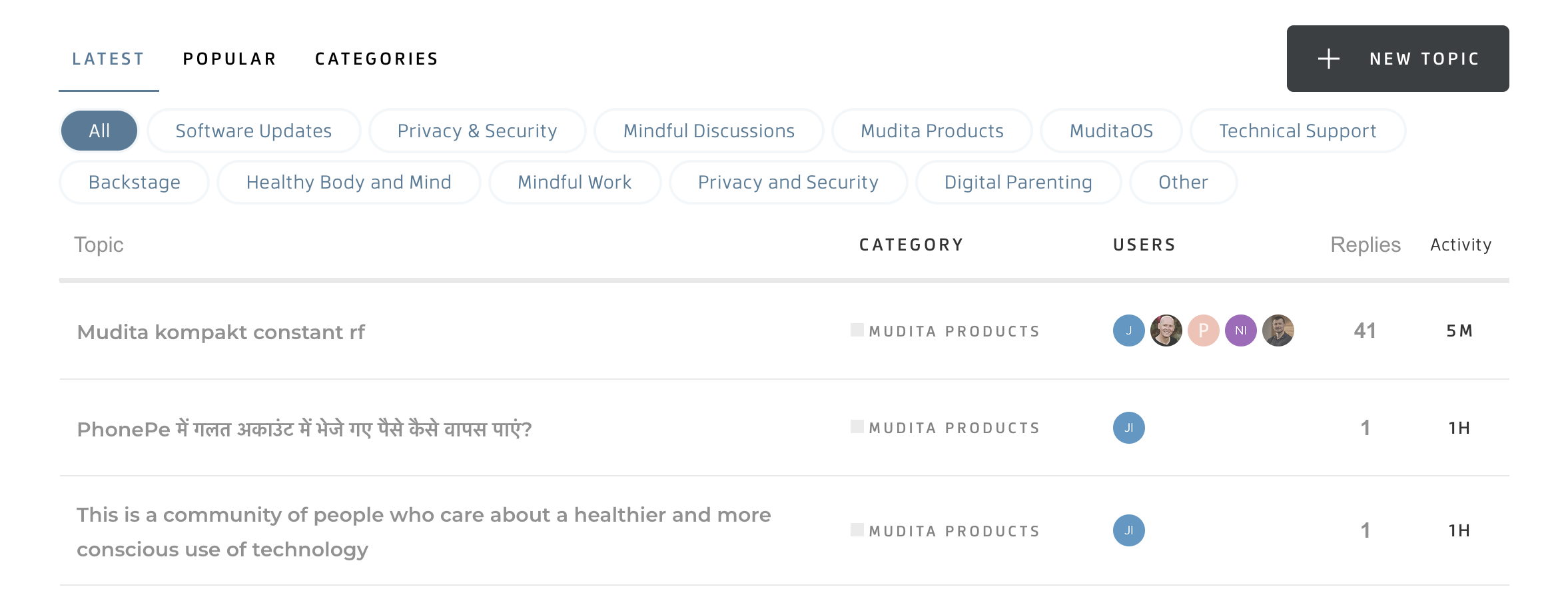

Here you have your ceo or director posting in the forum that has 2 SPAM topics under that topic.
It’s BAD OPTICS, and doesn’t scream confidence Security Wise to anyone that sees this.
If someone concerned about security they can’t believe your team saying they take security very seriously if it takes them months to tackle a simple Captcha in the forums.
I hope I’m more clear with this.
@gezimos I understand the frustration, our forum tech team is aware of this.
However- regarding the image you posted: When did you take this screenshot? Those posts were deleted and users’ IP shortly after they were posted? Are you still seeing them now?
@urszula No this was 4-5 days ago, I just took the screenshot but forgot to post it.
My point back then was “This does’t look good in the eye of the potential buyer” even a buyer with non technical skills can notice such issues. And your team knows for other issues that I’ve reported privately.
