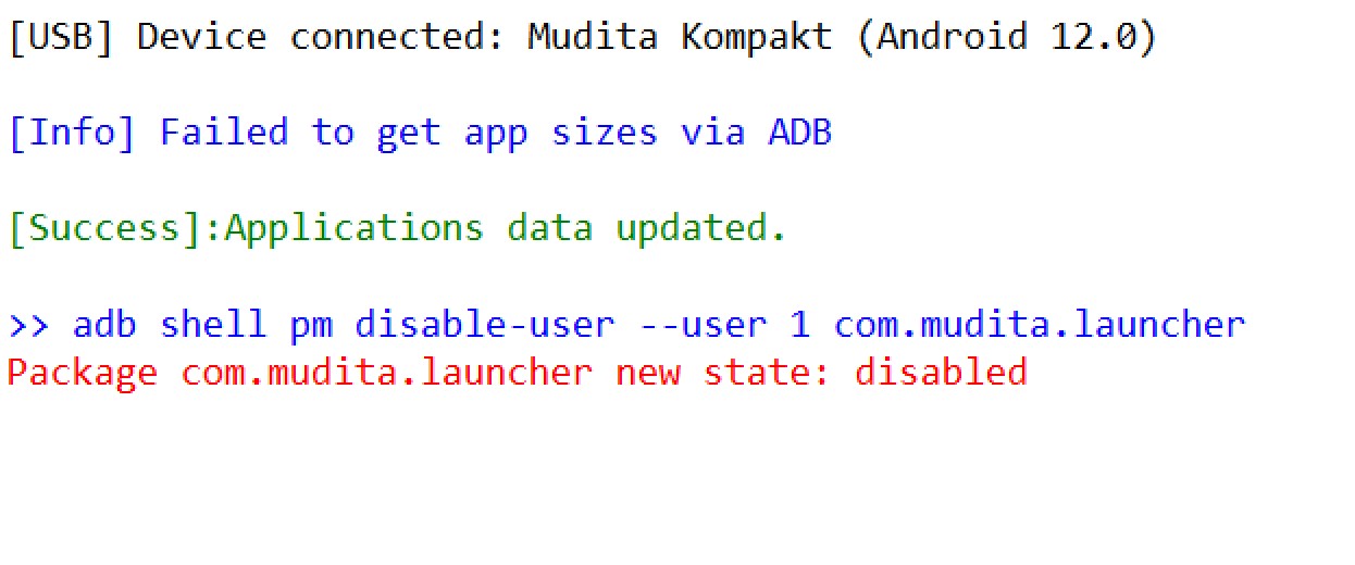

Hello, unfortunately the code does not work for me.
It is displayed that it is switched off, but i can’t get back to the original mudita launcher.

I too eventually found myself in this predicament and wound up performing a Factory Reset to restore functionality.
@larsenb This command worked for me to enable the default launcher again:
adb shell pm enable com.mudita.launcher
I think, if the default launcher disabled there is no way to launch it on the phone. You have to enable it again using ADB. Once it is enabled, though, you can not switch to an alternative launcher. It is somehow overruling the whole sytem. So either you enable the default one and use it, or to use an alternative one you disable it.
Yes, that was the answer I was hoping for, thank you very much zoltan :grinning:

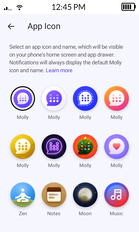

Sometimes even some apps let you select an individual icon. For example, this is Molly/Signal:
