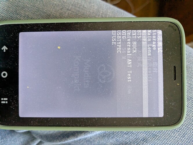

I am having the same issue. Phone has been working, ran out of battery, recharged, tried to turn on. Buttons move me up and down the menu or change the menu (including between Eng and ?Chinese characters) but won’t power it down. See photo.
I was able to resolve with a battery down/up cycle, but this was TS advice that came a couple of days later:
“When it comes to the chinese symbols error - please press volume down until you reach the bottom. Then click Power and it should vanish and everything should be alright. Please try this and let me know if you still need help.”
