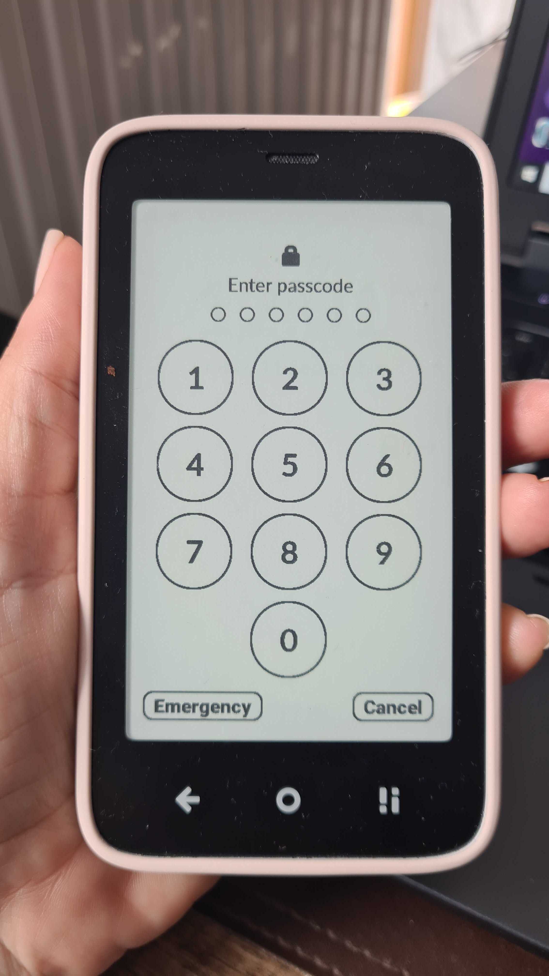

I’ll try to enter the phone, but it asking me to enter a 6 digit PIN instead of my saved 4 digit code.

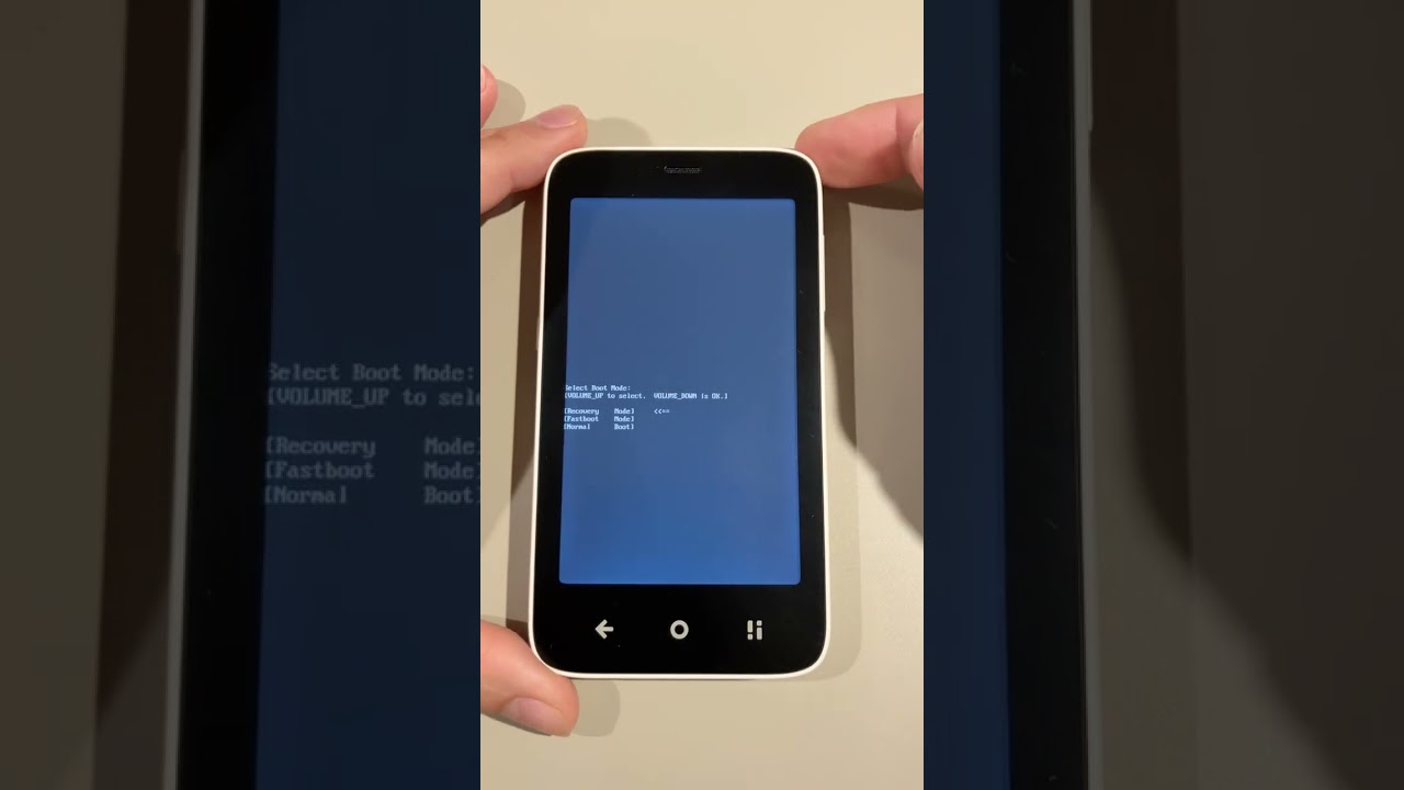

Entering Bootloader-Menu, choose “recovery mode”, entering by pressing "Vol.Down”, but my Kompakt is loading the normal environment without entering the Recovery Manager.

For PIN-Setup: Phone asking me only in Fingerprint-Setup to set a PIN, here I put only 4 Digits as my new PIN, which was accepted.
After my first restart, PIN prompting comes up (to connect with Mudita Center-App on my Computer).

AND any available boot-option starts anytime the phone in regular way:
Select Boot Mode:
[VOLUME_UP to select.   VOLUME_DOWN is OK.]
[Recovery  Mode] <<==
[Fastboot  Mode]
[Normal    Mode]
By the way: I’m testing any stupid PINs (000000, 123456 etc.) to enter the phone - nothing works!

This part you have to be a bit patient, because in this part the screen refreshes very slow. So take up to 5 seconds to se if the <<== is on the correct line before you hit volume down.
2nd thing is Mudita doesn’t allow 4 digit pins for the phone. So that can’t be the case for the phone pin. (they force you to enter a 6 digit pin when you set up the pin).

thank you for your hints about the delay time of choosen Mode in Boot-Menu.
I entering this Boot-Menu a lot of times (maybe > 50 times) in all type of choose :wink: , also waiting more then 5 seconds after tipping VOLUME_UP-Button.
I understand the 6 Digit forcing function, but I never entering this PIN-Management with the known restrictions.
I only create new fingerprints and here I need to entering a new PIN, and here Mudita accepting 4 PIN digits and I’m not sure why!!!

After you enter recovery, do you get a dead android graphic (android 3d mascot that has fallen down) ? Or does it straight up boot to the phone?

In general I know about the dead android graphic, long before I switched to Apple 15 years ago :wink: .
But I never reach or saw this recovery mode “splash-screen”.
My Mudita booting up straight into the normal mode, after choosing recovery mode (on my side the same effect like choosing normal mode).
And again, I’m not sure why Mudita OS accepting my 4 digits PINs by creating new fingerprints, mmmh!

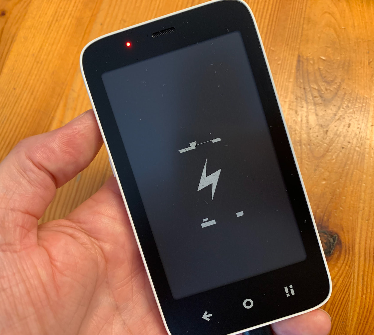

Update:
I send the damaged charge-screen (below) of my Kompakt to Mudita-support,
…and @urszula without (PIN) authentication = I have no logfile access when I connect the Kompakt to my Computer!

From both screens on this photo and the video you shared, do not match the images that appeared on my phone. So you either have an earlier build (pre 1.0.0) or you have a later one.
