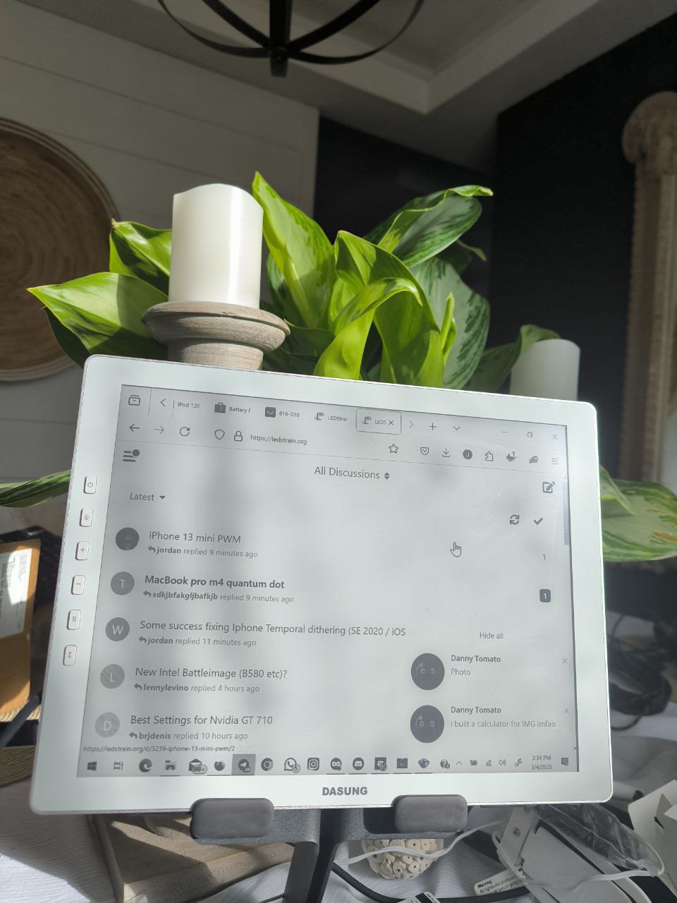

btw heres a pic of my dasung 13.3

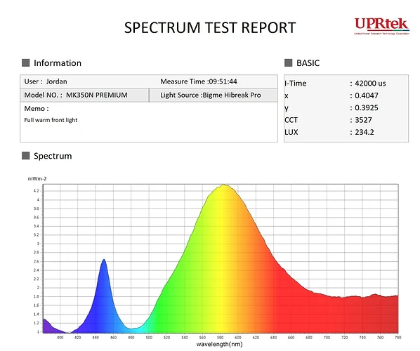

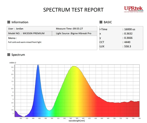

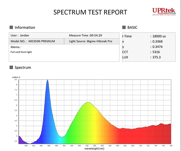

This test I did of the hibreak pro
