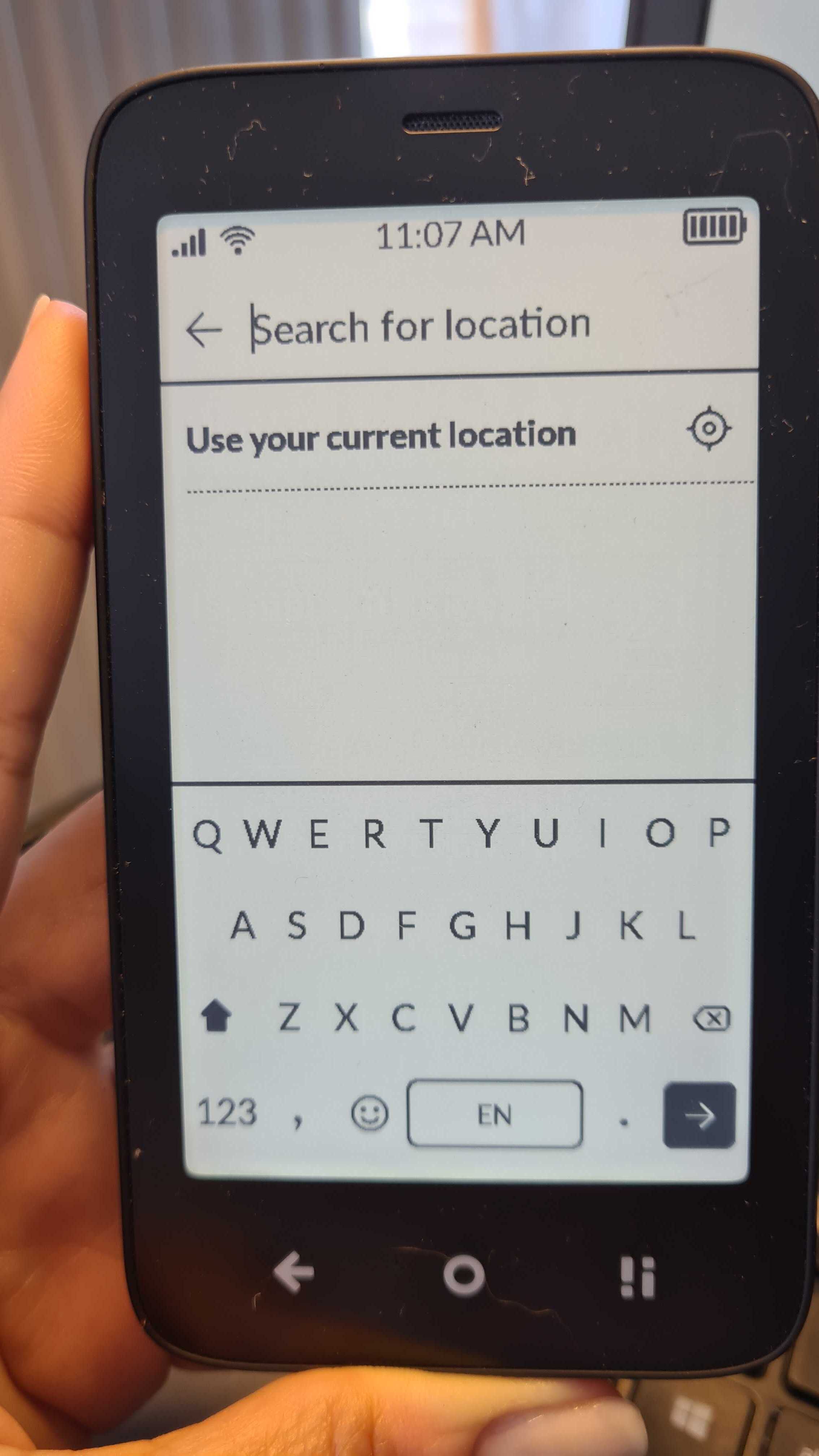

You can change the default location from Warsaw but it is a little buggy. Play with adding your location and deleting it, I’m not sure exactly what sequence of hopping on one foot while sticking your tongue out, rubbing your belly, and patting your head at the same time got it to work but after a couple minutes of fiddling it finally had my location showing and removed Warsaw altogether.

I think this is how I did it…
  1. Open weather
  2. Tap the pencil icon
  3. Tap the default location, Warsaw
  4. Type the name of my location and select it from the list
  5. Save it
Or something like that!

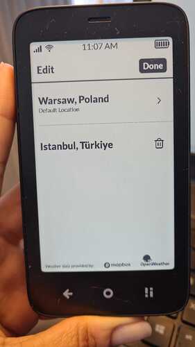

You can definitely do that :slight_smile: Just click on the pencil in the weather app.
This just adds a weather location, it doesn’t change the default one. In other wordss, how do you delete Warsaw in the above example?
You change the default Warsaw one to your city, you can’t delete the default one you can change it only.
