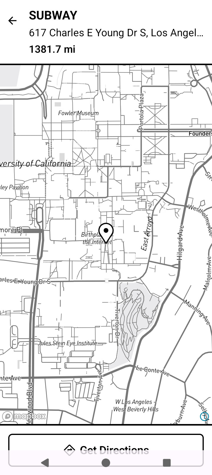

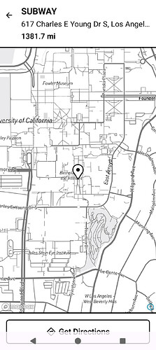

I installed it on a deGoogled smartphone and saw this when I chose a restaurant close to a location that I set manually in Los Angeles, CA:
Two issues caught my eye:
  1. The [Get Directions] pushbutton at the bottom got “fade-obscured” by the Android navigation bar. This problem occurs both with my deGoogled smartphone’s default Trebuchet launcher (which comes with the iodéOS operating system) and with the inkOS launcher from @gezimos.
    Perhaps the issue does not occur with the default launcher on the Mudita Kompakt, but I wonder whether you may want to account for users of other launchers and may want to have CalmMap look good on other AOSP-based cellphones.
  2. The distance at the top of the screen – 1381.7 miles – should be less than one mile from the “Default Location” that I saved in the Settings of CalmMap – with “Use device location” disabled – but seems to be the driving distance from my current location in Texas (confirmed when I tapped the [Get Directions] pushbutton and then pinch-zoomed into the starting location on the map).
    Perhaps I misunderstand what “Default Location” is supposed to do when “Use device location” is disabled!

Issues:
  1. All of my apps will currently have that navigation bar issue because the kompakt hides it. I’ll be updating them to respect it when present.
  2. The navigation currently always uses the device location (anonymously with Mapbox). That’s on me. I should have been more clear about that in the release notes. It’s on my priority list to respect the location setting from the settings page (default or device location).
